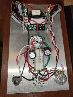

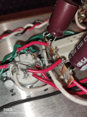

Thanks for the replies i have attached some  photos of my build
    • Posts: 20300
Reply #4 on: January 07, 2021, 12:45:54 PM
The 10K/3W resistors are not properly connected.  I would suggest reviewing page 43 of the manual and the installation instructions.

actually just as i took those pics again i did the test checked out for those two terminals and the rest also fine... strange.
Paul thanks for the reply , on page 43 it says crimp the leads into place, doesnt it mean what i did there? but actually i realised in the photos looks like the leads on all 7L9L and 3U were "trimmed" as well after the resistors are in place, is that what you mean but not properly connected? should i just trim the leads on the 7L9L and 3U which are sticking out?
    • Posts: 20300
Reply #6 on: January 07, 2021, 01:06:49 PM
From the bottom of page 43:
Gently pull the leads inserted into 7L and 9L
taught and crimp them into place on their
terminals.
You need to pull these leads tight, one of your resistors looks like it is very close to touching terminal 8.  If this happens, one half of the 6080 will attempt to draw as much current as it can until it melts down your amplifier.  You would also get a bad resistance reading at that terminal as a warning not to turn your amp on.
you are right it does look very close to terminal 8 which is probably why initially the res chk didnt clear. but if it is now, and I am going to go ahead with the SB upgrade which i read on the manual says that i have to eventually remove the 2 resistors, i may as well go ahead with the upgrade.
