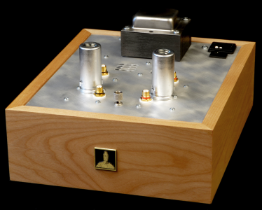

I just ordered my Reduction and trying to figure out what I want to do with the wood (I don't want to 'color' it per se, but something that really brings out the woodiness and makes it pop).  What finish does Bottlehead use on the images on their site?

What was done to the wood on this (what they show on their site?)

I use "Tried and True" finishes on my bottlehead bases. It doesn't contain any nasty toxic chemicals.
You'll want to put some kind of a coating on the bell end too or it will rust. Spray paint is fine. Some of the guys around here use gun bluing which looks real nice. "Birchwood Casey" seems to be a popular brand.
    • Posts: 20257
I also recommend Tried and True.  It is very close in appearance to what we use for the kits we photograph, which is often either gun stock oil or linseed oil.
2 or 3 coats of Tried and True will bring out the beauty of the wood and give it a wonderful sheen.
Adrian C.
    • Posts: 9772
The more recent bases in the product shots have been done with a little bit thinner oil than linseed oil alone or gunstock oil. I think I used Watco Danish oil. It seems to pop the grain very nicely. Re the bell ends, bluing is not a very good protectant against rust by itself. It is best sealed with something - oil at the very least, or a clear coat. I think my favorite finish for end bells is vein type powder coat. Make sure the bell end is meticulously clean before attempting to put on any finish. Acetone works well.
