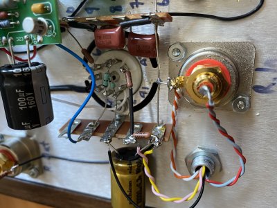

Finally receieved Sowter 1990s this week and installed in my Eros.
Everything has been working fine, albeit requiring huge gain on my LOMC cart.
All resistances check out except to left and right input centre pins where reading is now 2.5 ohms on both (47.5k expected)
I figured this might be something to do with the SUT so took a reading at 2 and 17 which would be the 'new' input after the transformer.
Readings are 1.267k and 1.272k.
This is precisely the reading if I measure across the 47.5k loading resistor.
The two sets of readings (2.5 and 1.3k) correspond to the resistance of the primary and seconday in the SUT (2.5 and 1500 approx is spec).
I wanted to check whether this is expected or if I have done something wrong before powering up and proceeding to voltage checks.
Picture of one channel attached.  Other channel is exactly the same, and has same readings, so any issue I will assume has been replicated.
I am also now left wondering whether I have the correct loading resistor (0.35mV Rega Apheta, 10ohm internal).
Any advice, corrections, explanation much appreciated.

This is as expected.
The loading impedance is 47K divided by the turns ratio squared, i.e. 470 ohms at 10:1, or 117.5 ohms at 20:1.

Many thanks Paul.
And thank you for confirming impedance.  I had calculated 117.5 (recommended 100 for that cartridge) but was unsure if the 1.3k in the SUT was a factor.
On with voltage checks and, all being well, some listening.
