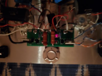

Reply #5 on: January 30, 2021, 02:02:01 PM
Thanks folks, I just rechecked only 1 led lights up. Please see the picture. Seems like the issue is there, what do you recommend I do to address this?
I also rechecked the wiring and it was accurate as per the manual

Folks, any thoughts from the picture?

Reply #7 on: January 31, 2021, 05:34:02 AM
Your picture is wildly out of focus.
You need to measure the DC voltages on the "I" and "O" terminals in order for us to help you determine what's going on.

If you want to get this working, you need to put the board back in and provide me the IA, IB, OA, and OB voltages.  Noticed in my last post that I asked for these four voltages and you only measured one of them.
It would also be really helpful to see in focus photos of the front and back of the PC board.  Most frequently with an issue like yours we find a soldering issue on the board or a component that isn't properly installed.   The last time I saw a component randomly bad straight out of the box was in 1999 and the company who made/sold has long since gone out of business.
