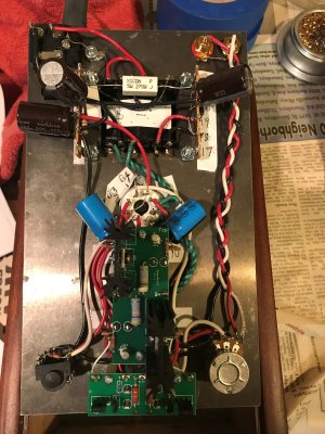

Thank for the reply Paul. Good to know that the S.E.X is performing better every day. Coming back to the Crack + SB, I replaced the tubes to what I had originally when I did my initial tests. These are the voltages I see:
T1 --> T5: -3.4 V (moves a bit around that number 3.41 - 3.45)
Large Board:
  OA: 110V
  OB: 111.7V
  G:   0V
  B+: 182 V
Small Board:
   OA: 182 V
   OB: 182V
I am attaching a pic of the build if it helps..
