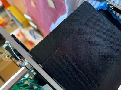

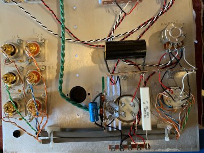

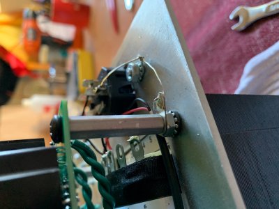

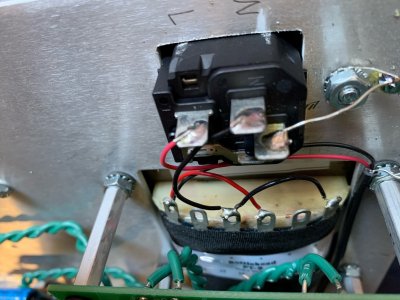

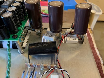

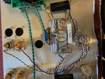

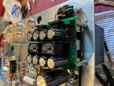

Attached pictures.
Any idea?
Thank you.
    • Posts: 20302
Reply #3 on: February 04, 2021, 01:54:41 PM
What DC voltage do you get between A1 and A4?  (One probe on A1, the other probe on A4)  How about B1 to B4?
With your source connected but not playing any music, is the hum present?  There will be some noise on any open inputs with this design, that's not abnormal.
I would definitely listen to a 60Hz and 120Hz tone to see which you have.
Were all your voltage checks OK?  How about the A2/B2 voltages?

    • Posts: 20302
Reply #7 on: February 04, 2021, 02:27:56 PM
Well, you have a perfectly functional preamp there.
It would be good to have you listen to a test tone at 60Hz and one at 120Hz to verify that the noise you have is 60Hz.
It would also be helpful to know that you have continuity (set your meter to beep when you touch the leads together) between all the transformer screws.  It's possible that this is just related to power transformer hardware.

    • Posts: 20302
Reply #9 on: February 04, 2021, 02:56:06 PM
What is the DC resistance between the chassis plate and terminal E on the IEC power entry module?

Reply #12 on: February 04, 2021, 06:17:56 PM
It’s 0.2ohms. I took it in different spots from below the chassis and its always 0.2 ohms.
