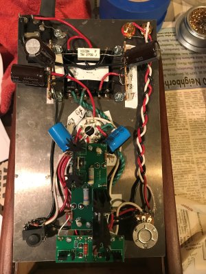

Hi,
Can you please let me know if the following voltages are OK on a speedballed crack (No issues with LED's lighting).
Large Board:
  OA: 110V
  OB: 112.7V
  G:   0V
  B+: 182 V
Small Board:
  OA: 82V
  OB:  78.6V
Am attaching a pic if it helps. OA/OB on the big board are high, right?
Atul
Atul
    • Posts: 20300
Reply #1 on: February 05, 2021, 05:59:20 AM
Yes, those are OK.  You have a 6080 with very strong emission and a 12AU7 that's possibly not quite awake.  If the amp hasn't been run much with that tube set, give it 50-100 hours of run time and then recheck the voltages.
