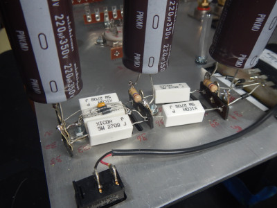

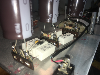

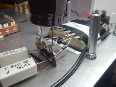

Hmm. There's not a lot that can go wrong there. I'd double check the orientation of the diodes. If that's not it, posting some detailed pics of the trafo area from different angles might be a good idea.

I would post a photo of what you've built and be sure not to proceed with the rest of the build until this is resolved.

HI - will send a few at a time. Thanks.

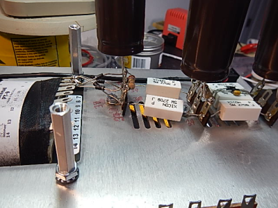

February 18, 2021, 09:17:44 AM
3

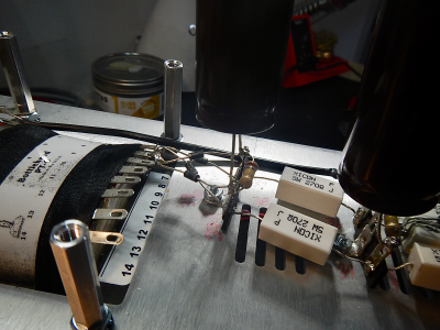

Reply #7 on:
February 18, 2021, 09:19:14 AM
4

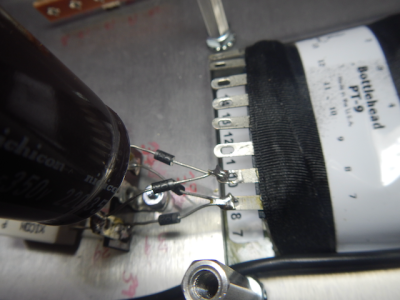

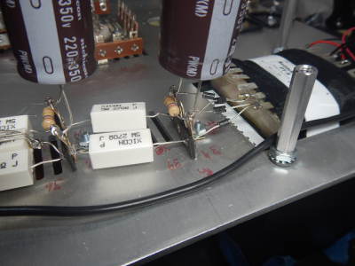

Re: failed High Voltage Power Test
Reply #8 on:
February 18, 2021, 09:22:48 AM
6

I would reflow some of your solder joints again, especially 37L. The convex dome shape seen in one of your photos can indicate a cold solder joint in my experience.

If 36 and 35 are shorted together with the lead of the 22R resistor, you'll blow fuses. If you have a diode backwards (you don't seem to), the fuse will blow. If terminal 8 and 9 on the power transformer are shorted out by diode leads, you'll blow a fuse (also looks unlikely from your build).
Some higher resolution photos with some more light would be helpful.
