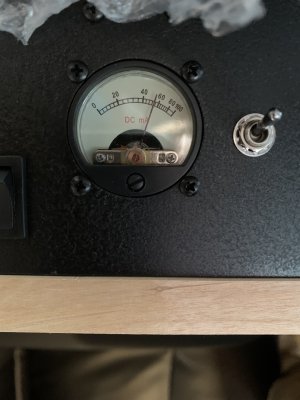

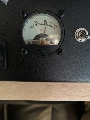

I'm able to adjust one meter so that the pointer is at the 6 of 60mA and stable.  The other meter goes up to 56 or 58mA but when left on for several hours starts to drift down and settles around 40mA. I saw a previous thread where someone described fluctuating meter readings and checked over all connections that might be contributing recommended in that thread.

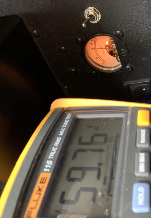

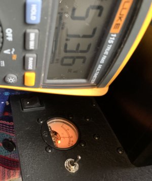

Yes. I included pictures. Pin 1- 59.76V and pin 4- 57.36V

    • Posts: 20296
Reply #10 on: April 24, 2021, 12:30:46 PM

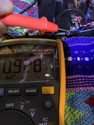

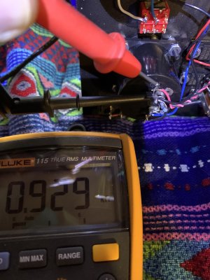

Please don't laugh. Either of these what I'm supposed to be doing?
    • Posts: 20296
Reply #12 on: April 24, 2021, 02:36:44 PM
You are measuring between the outer pairs of lugs.
The two outer terminals where the red/black wires go is the light for the meter, so ignore those.
The other two terminals are for the actual meter mechanism.  You need to lift all the connections to one of those two terminals (doesn't matter which one), then you can check the impedance of the meter itself.
