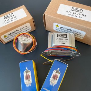

I've decided to try the basic Altec 1566A circuit with some mods to get the circuit as quiet as possible.
Some of my parts arrived today. l went with Jenson transformers (JT 115K-E & JT-10K61-1M) since the Peerless ones are hard to find and also cost a fortune! (as already stated)
