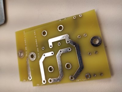

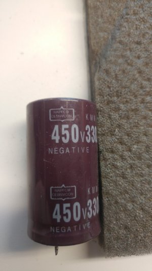

I've attached some random images of Chinese amp repair, including a couple of counterfeit NCC capacitors and a board I hade to make for an Audio Renaissance 845 amp that kept blowing up (50% from fake/bad parts and 50% from poor design).

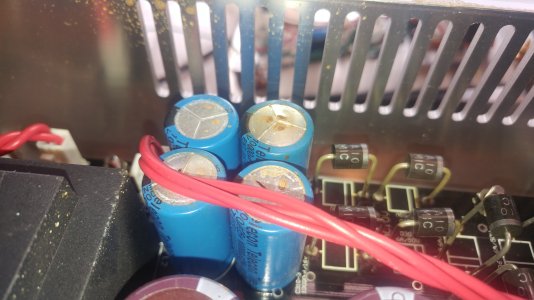

Here are some blown caps.  The tubes the amp came with outlasted these.

Love that board PB.
