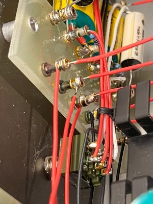

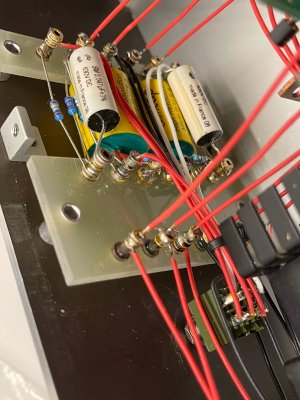

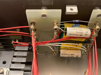

Well, I found something interesting reading the owner manual about CCIR vs  NAB equalization. It says if you play a CCIR tape on a NAB eq. it will sound muffled. All my tapes are CCIR and the switch has always been in the up position, which is the right position for CCIR.
I tried to put the switch in the down NAB position and everything sounds fantastic. Sound is crystal clear, airy. Bass is correct, tight and not overwhelming.
For me it looks like the switch is inverted. Is this possible? I attached some pics. No one seems to have ever touched the wires or soldering of the switch. From what you see on the pics, does it seems inverted?
I really don't get this one... I guess it's probably something else but it's kind of strange...
    • Posts: 20222
Reply #7 on: March 08, 2021, 10:01:22 AM
Your EQ circuit is indeed wired backwards.  I do recall there being an issue about ten years ago where this popped up.  We could certainly address this for you.

I'm relieved the problem is finally solved!
Is the switch only inverted or there could be more mismatch in the eq circuit from what you recall 10 years ago?
If it's only inverted, I have no problem leaving the switch in the down position but if something else from those production dates should be verified, I can send it to you.
Your help is much appreciated. I am quite impressed with your customer service!
Gilles
    • Posts: 20222
Reply #9 on: March 08, 2021, 11:59:21 AM
The switch wiring is just inverted.
