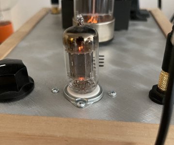

So the 12AU7 looks like it might have a teeny tiny air leak. The chrome treatment stuff that keeps it a vacuum seems almost used up. I’ll post pics here, but for example, I can see the tube light from directly on top. I don’t know that I can remember if it was “always like that,” it’s something I noticed over the last few months.
1- should I proactively replace it? Or just wait till it goes ?
2- what are recommendations for replacing? And where would ya’ll recommend I get it? (Not necessarily interested in tube rolling so much as stock aproxímate.).

I would post a photo.  What you're describing does not sound like an air leak.

And here it is from the front:

 I would keep using that tube.  It might only have five or ten years of life left in it.

FYI if the vacuum fails and air is getting in the tube you'll see that silver turn white.

The chrome thing is called getter flash, it is normally made of Barium to absorb residual gas inside the tube.
It seems your tube still has lots of getter left, so no worries. If the chrome is completely gone, or becomes milky white, then the tube will stop working due to losing its vacuum. Until then you can replace it with a new one.

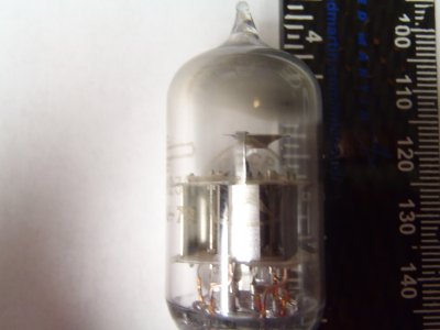

BJK here is a photo of a tube that sucked air. Cloudy grey color, nothing shiny. It sounded fine for a few minutes but as it heated up there was scratching from the channel as the tube began to really glow, the whole thing bright orange as I reached for the off switch.
