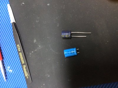

Reply #2 on: March 14, 2021, 07:38:16 AM
PB,  the old capacitor is on the left, the new on the right.
John

Reply #5 on: March 14, 2021, 08:34:27 AM
PB,
I apparently grabbed a thumbnail the first time.  Try this.
John
    • Posts: 20348
Reply #6 on: March 14, 2021, 09:09:45 AM
That indeed looks like a 220uF cap.
If the old cap died, possibly from excess ripple current, I wouldn't put in something physically smaller.  Perhaps consider a 50V or 63V cap as a substitute that's a little more substantial, especially if that new cap you have is a Panasonic FC.
