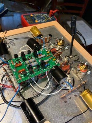

Can you post some photos of the top and bottom of your center C4S board that's mounted up front?

Reply #9 on: March 14, 2021, 01:37:14 PM
I’ll try to get some photos. I tried plugging in the unit to my stereo and I started getting a kind of rumbling with a hiss type noise from the right channel. Left channel was quiet at first, then after about a minute I started getting a similar but not quite the same noise from the left channel. This is with the unit plugged on and connected to the amp, but no record spinning.

I did have all the interconnects connected.
Btw, this the bottom photo was taken prior to the center leg being resoldered.  The top is current.

    • Posts: 20253
Reply #12 on: March 14, 2021, 02:25:54 PM
It looks like possibly you may be using lead free solder, or perhaps an iron that's not hot enough (maybe both).
The LEDs bias the current source loads.  They have to be HLMP-6000 diodes, other choices may simply not work properly.
