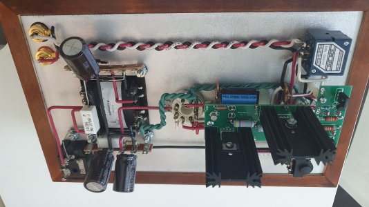

After some time, I check the crack to find out what just happening. I can see the 220uf 250v from 20,21 got leaked it fluid. its smell burn and blown outward little bit. What should I do now? the seller do send me the soft copy of manual thru my email. But I just cant figure out where should I start to do a troubleshooting. There is any suggestion for me to order the spare part thru online? I live in Saudi Arabia and I have very limited source from local store for electronic part.

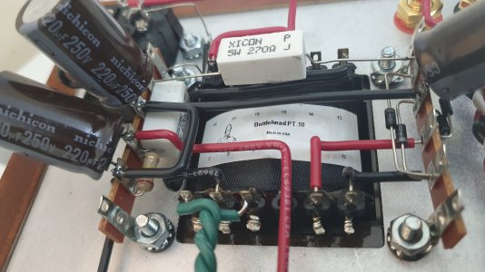

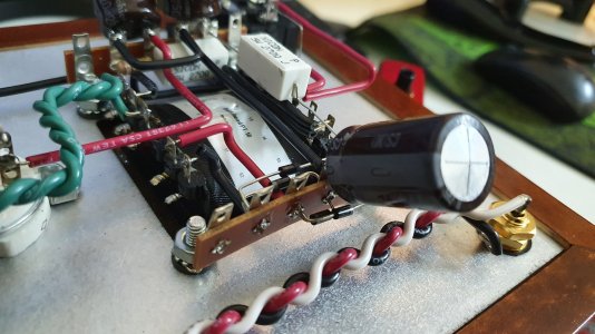

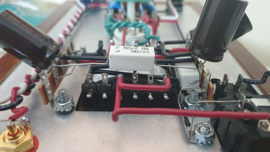

I can send back the crack but it will cost me almost same amount with a new kit (without build) consider the shipping cost and custom fee from here to US and US to here again. I attach some picture here. I might consider restore again the crack but i need to figure out the problem 1st and find a way to order the parts online.

Reply #3 on: March 22, 2021, 07:33:55 PM

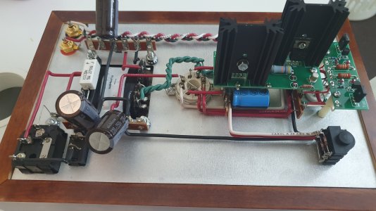

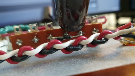

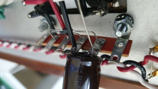

Reply #4 on: March 23, 2021, 01:26:05 AM

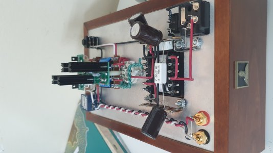

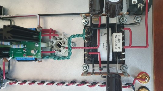

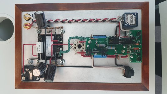

I attach more picture for the amp
    • Posts: 20302
Reply #5 on: March 23, 2021, 05:23:41 AM
OK, everything looks OK other than that cap.  Are you absolutely sure you plugged it into a 120V outlet? (It's not wired for 110V).  If you plugged it into a 220V outlet, we would expect this exact issue.  There is nothing otherwise wrong with the amp visually.

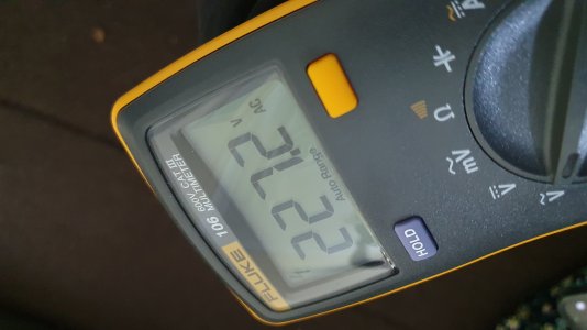

There are 2 wall power outlet available here in saudi arabia. one is 110v for normal appliance and another one is 220v for heavy usage like AC, Heater or fridge. I plug in the extension cord to the 110v and the plug the power cord of the amp to the extension cord. I accept my fault that I did not double confirm the voltage output by using multimeter. I keep asking the same question to my self from that day, really its is 110v is coming from that wall outlet> :o

You need to buy a digital volt meter and measure the actual AC voltage you have available, I can just about guarantee it is way above 110V.
