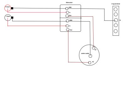

I have attached images of my understanding and of how I was thinking of wiring it. Hopefully they are somewhat clear and helpful.
If you would be so kind , I would greatly appreciate if you could let me know if this seems okay, if I am missing something, or anything else that you think I should know.

I would suggest building the amp stock first.  Once you have gone through that process and have the kit up and running properly, then you will have greater confidence in getting that stepped attenuator properly installed.  Building the kit stock will also reveal a problem that will arise with the drawings you posted.

Hmm, I'm curious what you are referring to. Looking at the completed diagram in the manual, I see that one single black wire runs through both RCAs and terminates at the upper lug of the pot after going through the lower one, which differs from my drawing in that I drew separate ground wires. I was thinking that if I could still use one single ground wire to connect to the attenuator I would but was unsure and 2 as I have not seen it any other way. If you are referring to something else, I am unsure.

Yes, the separated grounds will be a big problem.
The issue with putting the stepped attenuator in from the beginning is that debugging the amp may require you to pull it back out and put the factory pot in its place.
