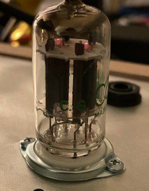

Do both halves of the 12AU7 light up?

Yes, I believe so. Here's a picture of the tube.
Thank you for your help.
