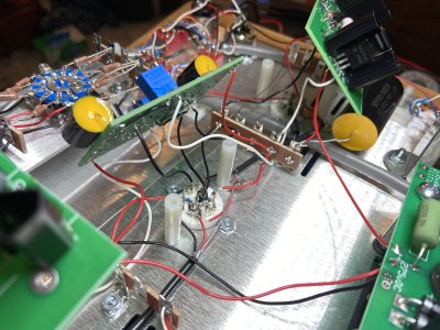

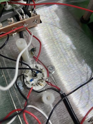

How is the solder joint at pins 4 and 5 on the 12AU7 socket?
You have an amp that looks like it's working nicely, except one half of the 12AU7 is not quite happy.  This could also be a loose joint on that socket as well, or perhaps one of the resistors going to pins 2/7 isn't quite all the way connected.

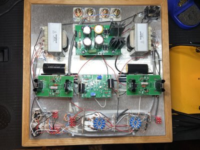

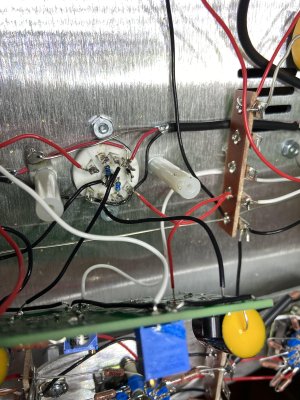

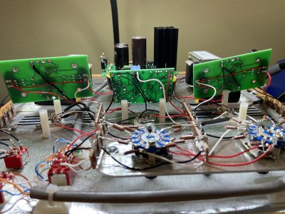

Thanks!  I’m getting close. The joints on pin 4 and 5 look ok, same with the resistors. I reflowed these just now and tested again. Unfortunately, still getting the same readings, and no glow from the 12AU7 (tried several known good tubes).
Here are some photos of the 12AU7 socket and overall photos of both sides of the boards.

I de-soldered (wick) and re-soldered 2, 4, 5, and the center of the 12au7 socket.  While not particularly pretty, this is what I have, The issue is now worse.  I'm getting 3.3V (Kreg B) and 4.4V (Kreg A).  Perhaps I fried these little stoppers?
