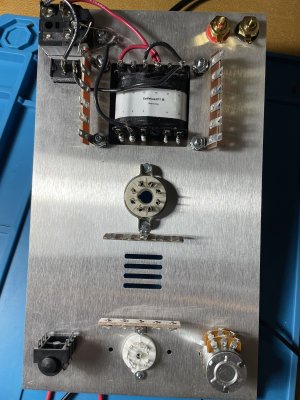

Reply #4 on: March 31, 2021, 07:04:38 PM
Uploading build pictures.

Reply #5 on: April 01, 2021, 05:07:23 AM
Looking at your photos my eyes tell me you need to solder the connections at the power switch.

Reply #6 on: April 01, 2021, 05:12:49 AM
You should trim that wire poking out of 16 as well, stuff like that will cause your amp not to work.  Your octal socket is not properly oriented also.
Along with soldering the power switch connections, what AC voltage do you get between 13 and 18 on the power transformer?

Reply #7 on: April 01, 2021, 06:02:25 AM
ok it worked. Although all connection were already soldered, i added more solder to all connections. It seems it was just a bad connection.
