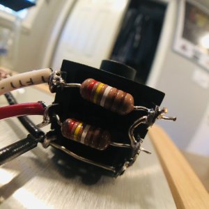

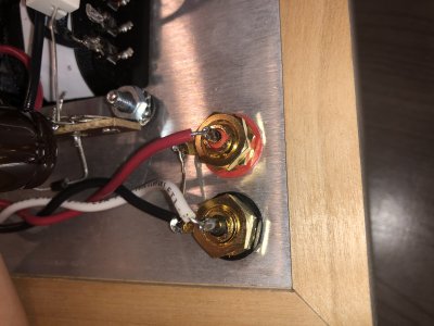

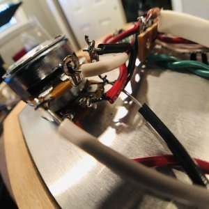

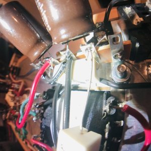

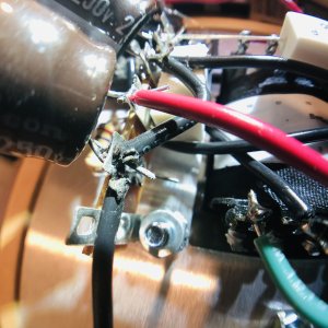

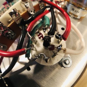

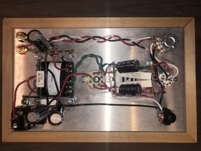

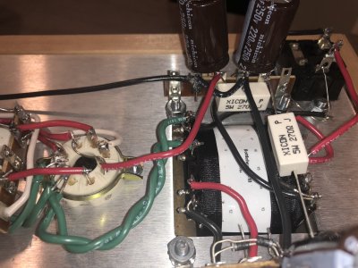

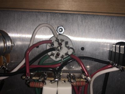

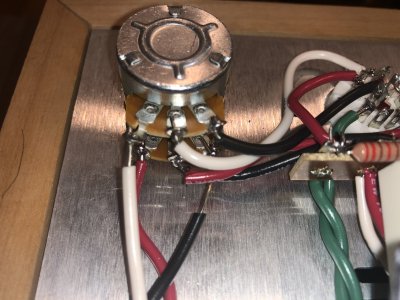

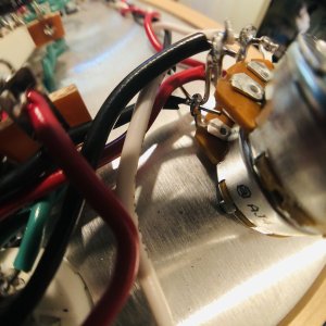

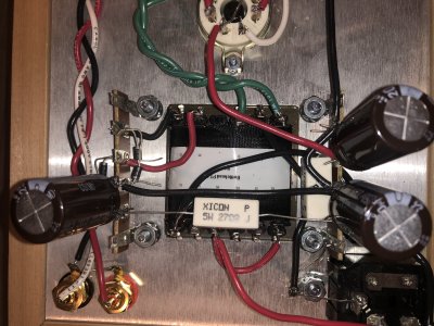

I narrowed it down to the Crack. I am going over the instructions again to see what I did wrong. I uploaded some pictures as well.

Some general build problems that you have revolve around how you're making your connections.  When the manual says "attach", that means to poke a lead through and at least bend it up against the terminal.  This is explained in bright red text on page 20.  I would go through your amp and remedy this.
You also have lots of long leads poking out of terminals.  Often this happens when builders don't have proper side cutters.
Can you post your voltages on terminals 1-10?

When I plug the Right RCA cable in, there is audio on Right only. When I only plug in Left RCA only there is no audio. When I plug both L and R there is stereo output on both L and R.
It's hard to tell from your photos, but do you have the jumper connected between the upper and lower levels of the volume pot?
