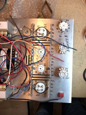

Hi I'm having difficulty from the instructions (page 14) seeing the difference between the larger and smaller holes on the 4-pin tube sockets.
"The larger holes MUST face the back of the chassis"
Are these installed correctly? Any other indications I can see they are?
thanks,
Larry

Reply #1 on: April 04, 2021, 05:48:48 AM
This is more easily seen from the top, could you post a couple of photos of the tops of the sockets with the hum pot shafts included for reference?
Thank you for stopping your build and coming here to seek help, it's a lot easier to get this ironed out now rather than after the amp is soldered up!

Reply #2 on: April 04, 2021, 06:14:37 AM
Another way of checking: turn the chassis right-side up in the base and insert the 2A3 tubes - the right way will be snug, but doable; the wrong way won't work unless you use way too much force to insert the pins. Once you figure out the right way, check whether the fat pair of pins are farthest from the front, and the skinnier pins closest to the front. If they are, the sockets are oriented correctly. If not, they need to be rotated 180 deg.
cheers, Derek

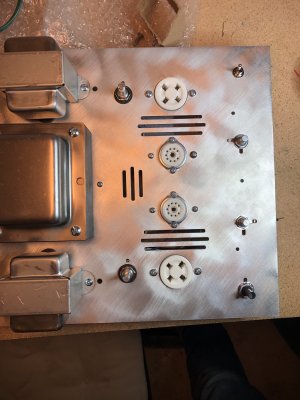

Reply #3 on: April 04, 2021, 06:24:47 AM
thank you, here are pictures of my current installation from top views, is this right?
Reply #4 on: April 04, 2021, 06:40:01 AM
One is correct, one is backwards.  The ceramic wafer has enlarged holes for the larger pins, which aren't so hard to see from the top.
Reply #5 on: April 04, 2021, 06:40:51 AM
D socket is backwards. Rotate it 180 degrees.

Reply #6 on: April 04, 2021, 07:15:56 AM
Yes I see exactly what you are talking about now. Glad I could fix it at this phase.
