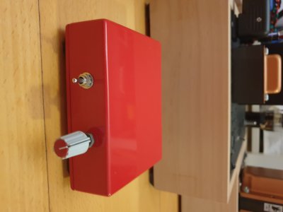

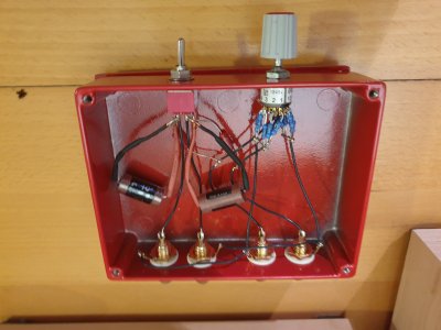

I made a simple filter box and insert between ForeplayIII and Paramount/Stereomour/MonAmour to drive the mid/treble
It use 0.01uF Jupiter cap and also build in shunt attenuator and bypass switch. Crossed over around 150Hz (depend on attenuator position and input impedance of amp).

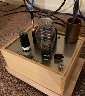

I took this quite literally by putting Harrison Labs FMOD 150Hz high pass filters on the Paramount input jacks (see photo below).  I had excellent success using a Harrison Labs attenuator on the right channel input to my preamp to correct for a channel imbalance, so I thought I would give the FMODs a try.
It worked out great and really cleaned things up.  I'm reluctant as the next guy person to put any additional devices into the signal path that can muck things up but these passive Harrison Labs devices work really well!  Thanks for the replies.
