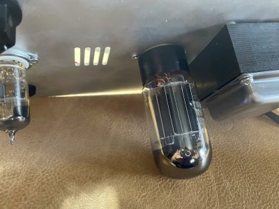

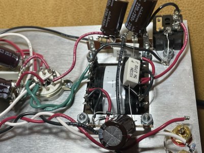

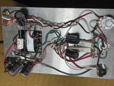

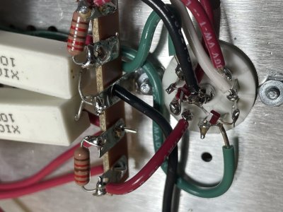

I am doing a check on my crack before moving on to the speedball. One thing i have noticed is that little LED does not light up but the headphone amplifier itself works fine with excellent sound.
I am posting some pictures if anyone can take a look at why the little LED does not light up. Does it matter - are there any obvious mistakes?

Is your 12AU7 glowing?
You are missing a connection in your amp. See step 2 page 35.

Let me fix that missing connection. Thank you for spotting that.

The LED lights up now. Thanks - it was the missing wire.
