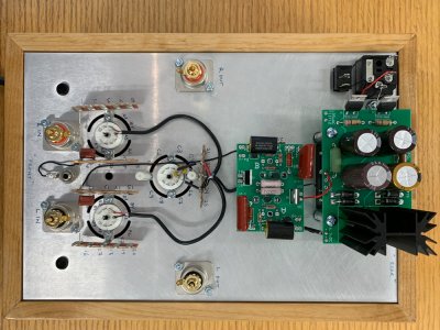

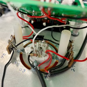

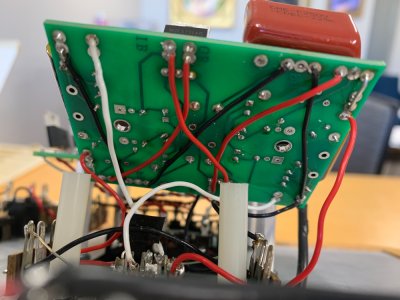

Can you post some photos of the build so far?  Also if possible the bottom of the C4S board?
Offline rsmiii
    • Posts: 38
Reply #6 on: April 11, 2021, 08:04:15 AM
Paul: detail pictures of my Eros 2.0 build as of 4/11/2021, through page 55 of the manual (2018).
    • Posts: 20348
Reply #7 on: April 11, 2021, 05:26:22 PM
You may benefit from more solder on the PC board joints.  Also on the 9 pin sockets, you want to wrap the leads of the wires/resistors up and over the top of the socket pins, not around the sides.  There just isn't enough clearance to reliably have them wrapping around the sides.
