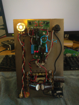

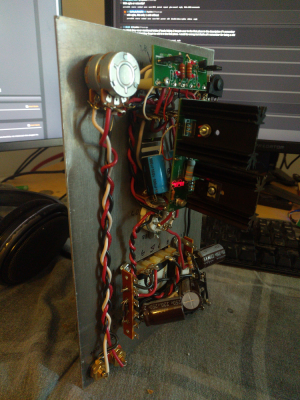

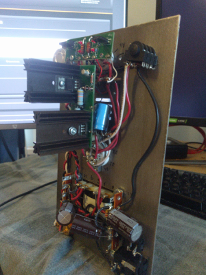

    • Posts: 4
Of course, I've attached some photographs. please excuse my inability to keep the point to point circuit looking nice 😅
    • Posts: 20282
If I had your kit here for repair, I would replace the 2N2222 and TIP50 transistors.  To do this without a good solder sucker, it's usually easiest to cut the transistors off first, then pull the leads out out of the board when the transistor is gone.  After that, solder braid may be able to suck the remaining solder out of the board so you can get new transistors in.
