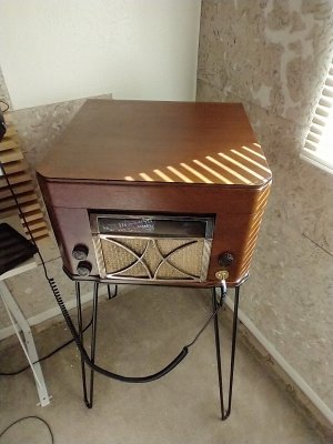

With just agreeing on the carpet left, I was able to complete my little project.
Bought off the bay, it started life in 1947 as a tabletop radio/record player. Someone had done a decent job on the outside finish but the TT was gone, the tuner glass was broken, a control knob missing, etc.

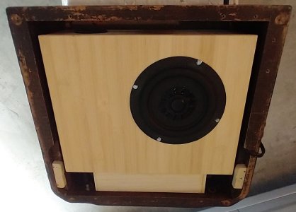

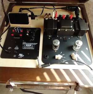

Ended up with a Scan Speak 10F in a small sealed enclosure, and Tang Band W6 firing down from a ported box. The S3X amp is augmented by a little 25W sub plate amp, and receives signal from a Fiio M6.
I added hairpin legs and it gets high WAF while sounding PDG!

If the innards had been more complete it might have made a nice restoration. Being rough in that regard made it easy to just finish gutting it and use the shell.
As PJ stated the headphones do play louder, but in our modest bedroom the speakers are plenty. Our clothes dryer has graciously supplied me with several single socks to stuff the port, helping to tame the boom from the corner placement.
