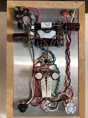

I have just finished building my Crack. The initial voltage tests from the power supply come out normal, and the resistance checks did as well. The tube glow test passed as well. With the final voltage check I notice a high voltage on pin 5 and pin 9. And the LEDs are both not lighting up.

On the 9 pin socket, look at pins 6 and 7.  They look like they are almost touching.  You really don't want these to touch, so trim those leads back!
The paragraph on the bottom of page 20 that's in bright red explains what we mean when we say "attach".  It does not mean to slip a wire or lead through a terminal and just leave it there.  You need to bend the leads around the terminals to make a mechanical connection before soldering.  You have lots of wires and leads just resting inside terminals, so I would go back through and bend the free ends up against the terminal strips and tube socket pins, then reflow your solder joints.
I would also be extra careful that both black wires that attach to the headphone jack are captured by solder.

You are also missing the wire from A1 to 5U

Thank you both for the quick response. Awesome. Can't believe I missed the wire. With the wire the voltages look within range and the LEDs come on.
I will resolder the connections next after attaching the wires properly.
I do notice a hum on the headset, could this be the solder joints? Or other thoughts?

Yes poor connections can cause hum. Poor connections at the power supply capacitors can cause hum.

That missing wire would only prevent one LED from glowing.  The bad voltage on terminal 1 with your initial measurements tells me there are still other issues.

I'm heeding your advice and I will resolder all connections over the next few days to remove the hum. Poor connections make sense.

You're moving closer to what's correct.   I would imagine your LEDs on the 9 pin socket are now lighting up at least.
