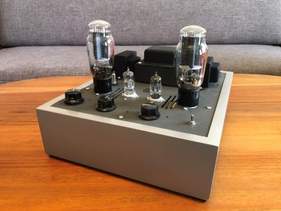

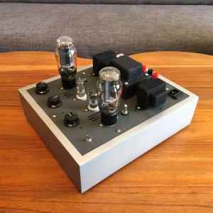

I ordered my Stereomour II kit in the summer of 2019. But it wasn’t really until summer 2020 that I started working on it, very slowly! I finished up in early November 2020, and meant to post here... but didn’t... UNTIL NOW!

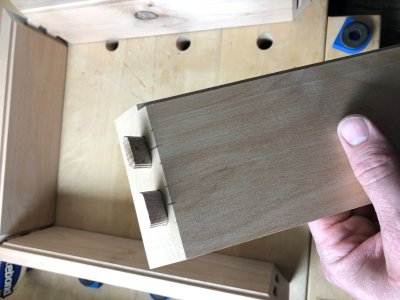

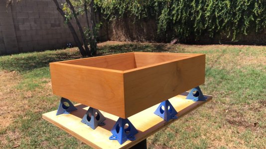

I probably spent more time fussing with the base and the top plate than anything else. I reinforced the corners of the alder base with festool domino tenons. I originally finished it with a precatalyzed lacquer, but I wasn't happy. I tweaked the color a bit with a lacquer toner, and was still unsatisfied. So I stripped all the lacquer off. I then coated it with a silver acrylic based enamel. I’ve lived with that so far, but I’m thinking of stripping that off too, and veneering, or perhaps a new solid wood base.

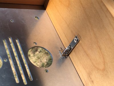

I purchased some keystone (#708) right angle brackets via digi-key to secure the top plate to the wood base.

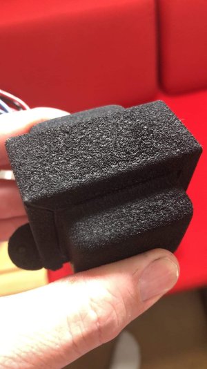

I used VHT wrinkle coat paints on the top plate, main trafo, and chokes. I know wrinkle coat is a pain to keep clean (believe me I know), but I love the look on old projectors and radios.

Nice looking build!
Deke609
Reply #2 on: April 23, 2021, 10:27:24 AM
Wow! Looks great. Congrats!

That wrinkle paint looks cool. I checked out a couple of vids on how to use, did you bake or use a heat gun to cure?
 I figured that the summertime Phoenix, Arizona sun was enough to bake it.
    • Posts: 634
Reply #6 on: April 28, 2021, 05:39:12 AM
That finish is great, I think it was worth the wait.
