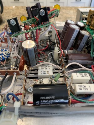

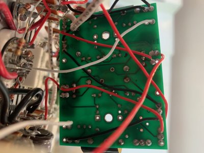

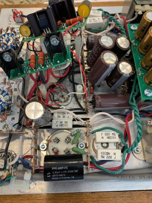

It would also be a decent idea to post some photos of your build.

I've tried a couple of times to upload photos, but I get a website error.  Perhaps the files are too large?

I will try again to post the photos.
