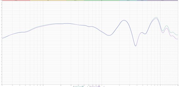

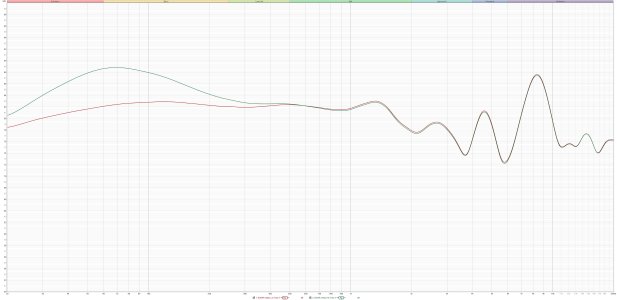

Hi Paul, yes I was expecting significant deviations in bass which I saw in the 80 and 120 ohm headphones, but not in 2-3 32 ohm headphones!?
For example, check out the 80 ohm Utopia measurement with the expected bass changes and then the 62 ohm AKG K712 with basically no change

If the impedance curve of the lower impedance headphone is super flat, you wouldn't necessarily see a significant change.
I wondered if that might be the issue. So, to confirm, the 1/8 rule does not work in reverse (i.e. output higher than transducer impedance) and damping would still be affected even if frequency response is not - right? The sound is a bit smoother from the high output socket, but it also has different (and more) components in the signal path.

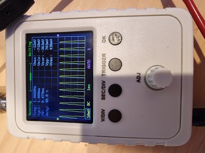

I ended up buying a portable oscilloscope like the one Dan suggested and I'm now using it to measure a completely different product (Matrix Mini-i Pro 3) that has published output impedance of <11 ohm (single-ended). I must be doing something wrong though because I keep calculating a Zout of about 1 ohm.
Can anyone help me work out my error? Here are my steps:
  • Connect oscilloscope to one channel of the headphone output
  • Play 1kHz tone through device
  • Record RMS voltage from oscilloscope
  • Apply known load (6.8 ohm is what I had at hand)
  • Record new RMS voltage
  • Calculate Zout as (V-VL)/(VL/R)
What am I doing wrong? Is the resistor too low? Should it not be the RMS figures for the calculation?
Here's a photo of the oscilloscope readout in case I'm doing something totally wrong. (By the way, it's set to AC mode, but is showing DC on the screen when connected - not sure what that's about as it shows AC mode correctly when disconnected)

The scope image is not a sine wave, so the amp is not working correctly with the load and the rms value is irrelevant. That's the reason for using a scope rather than a meter - to confirm that the signal is in fact a sine wave and the amp is working within its limitations.

Duh, I didn't blow up the image and see the data. Yup, either the wave form your inputting is not really a sine wave or you need to move the trace up so you can see the entire sine wave.
Thanks for confirming that. I wasn't sure if these little scopes showed you only half of the wave to save on screen space. It must be something to do with it showing me "DC" as the mode when connected, even though it's definitely switched to AC mode and shows "AC" when disconnected.

If the settings are available you want to shrink the vertical scale (i.e. use bigger volts/division) so the full wave fits on the screen. Also move the zero crossing point of the waveform (half the wave above, half the wave below) up to the center of the screen. On a "real" scope there is a position control for this.
Thanks Dan - I'm trying to work out how to do this with the very limited instructions. It's concerning to me that it seems to be not holding "AC" mode so I don't know if that's part of the issue too. I'll keep trying...

If the AC/DC mode switching is automatic it may be that the waveform is not being recognized as AC since it doesn't look like a sine wave. It looks more like a series of pulses. Try to shrink the vertical swing by lowering the signal or by changing the vertical scale to a bigger volts per division setting and see if the mode stabilizes when you have the full sine wave showing on the screen.
