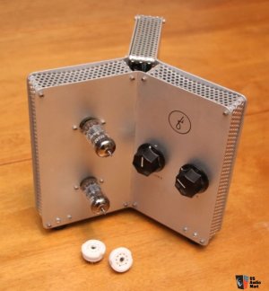

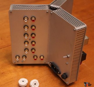

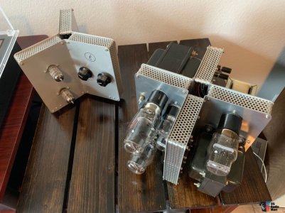

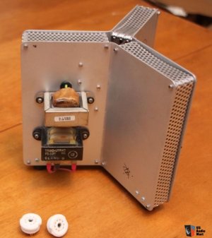

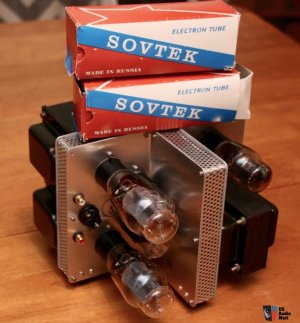

they seem quite similar to 12au7's and 6sn7's. I agree that there is not much info about them but I have read some articles that suggest that they should sound nice. I read about  using shielded cable for the grid connection and will do so also. I love the look of the tube also. I have all the parts and 4 Ken-Rad 7193's, I'm in the process of designing a chassis using Front panel express. I may try to design a chassis similar to a Fi audio style preamp or power amp. will definitely post when the build gets underway. check out the attached photos of a couple of Fi audio designs, I think they are pretty cool but not the easiest to build. I may also go with a more traditional chassis if I can't wrap my head (and my budget) around it.

Regarding the Fi amps, Don was an amazingly creative artist and a friend. I'd recommend copying the look, but you might want to spend some time thinking about the wiring layout. Back when we were all just getting into this SE stuff I recall Don sending a preamp to Buddha to sort out some fairly gnarly noise issues that were subdued with some reworking of the grounding and wire dress. IIRC the issue was at least partly due to the many separate panels and how they were connected.

Roger that Doc,
While I like his design aesthetics I realize that the build will be brutal, therefore I will build a more conventional chassis.
