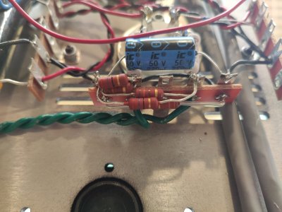

For some users of the BeePre 2 with highly sensitive systems, the following modification will lower the noise floor of the preamp for the cost of a few resistors.  You will need four 27 Ohm Vishay PR-02 resistors.  I recommend part number PR02000202709JR500.
In the BeePre, install one resistor between 22U and 25U, another between 24U and 25U, another between 27U and 30U, then another between 29U and 30U.  I recommend positioning the resistors at 24/25 and 29/30 above the resistors already there so they are out of the way (see the attached photo). If you have trouble getting all the leads through 25 or 30, the unbanded lead of the 220uF cap can be moved to the lower terminal to make more space.
This will drop a bit of buzz that resides in the noise floor that I have a tough time picking up in any of the test systems I have here, but could certainly come through with headphones or highly sensitive speakers.

I just wanted to double check one thing before installing. From the instruction you gave one goes on U22-U24 and the other on U24-U25. (Than mirrored on the other channel).
From the picture you attached it seems to me that one goes on U22-U25 and the other from U24-U25. Am I mistaken?
Thanks in advance.
Best
AB
Reply #2 on: May 12, 2021, 05:42:18 AM
You're correct, I just amended the original post to reflect that.

What an outstanding result!!! I couldn’t be happier. The noise dropped by a lot! To give an idea, before installing the resistors I had a -12db pair of attenuators into the Kaiju and I had hum at half way volume of be beepre2. Now I removed the attenuators and I get a slight noise at 3/4 of the volume pot (it would be impossible to even try to listen at that level).
To summarize, very happy!! Thanks PB and BH team.

This modification did exactly what I hoped.  The volume dependent buzz from the speakers was dramatically reduced.  It is only audible with full gain on the Kaiju and 3/4 volume on the Beepre and no audio playing.  Speakers are Klipsch Cornwall w/ fresh tweeter, mid horn driver, woofer, and crossovers from Crites Audio fwiw (96db I think).
This DEFINITELY increased the enjoyment in listening to the new equipment.  THANK YOU!
