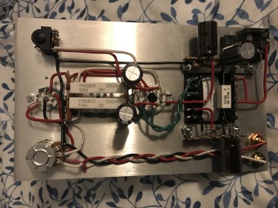

Yes, only half of 12AU7 is glowing. Here’s some pictures. Hope they they shed some light. Thanks for your patience.
    • Posts: 20260
Reply #5 on: May 20, 2021, 06:58:34 AM
The green wire around A4/A5 does not look like what's in the manual. That is really the only cause of half of the 12AU7 not lighting up.
