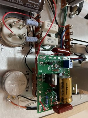

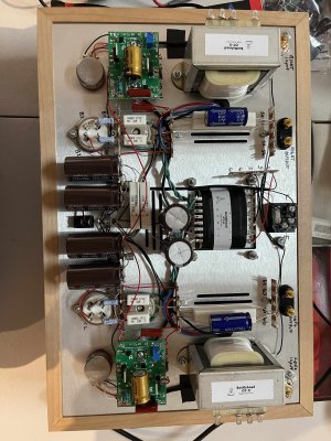

The A Board measures as follows:
IA= 512 VDC (fine)
OA= 298.7 VDC (fine)
Terminal 32U = 4.15 VDC- 8.99 VDC (depending adjustment of potentiometer).  (VERY LOW READING)
The D Board Measures as follows:
IA= 510 VDC (fine)
OA= 355.4 VDC (VERY HIGH READING)
Terminal 46U= 175.2 VDC (adjusted w/ potentiometer correctly).
One discrepancy I note from the instructions vs the parts list is the 0.1uf 630v metallized capacitors.  The parts list included 4 of these.
The manual calls for 0.1uf 400v film capacitors to be used on page 59, but these weren't included in the kit.  I used the 630v capacitors on the board instead, assuming this was the intent.
Anyone's eyes see my error here?

Update: the low reading on 32 seems to be a bad connection.   Tilting the board corrects that problem.   I’ll find the weak spot there.
However the oa reading of 354v is perplexing me.

OA needs to be far closer to 300V.  What's the Kreg voltage on the B side of that board?
Offline Roamconstant
    • Posts: 23
Reply #7 on: May 21, 2021, 02:57:11 PM
On the b side of the d board, the Kreg voltage is 12.67vdc.
On the b side of the a board (which measures correctly), voltage is 7.2vdc.
    • Posts: 20297
Reply #8 on: May 21, 2021, 05:17:42 PM
12V on that Kreg and 350V on OA/IB means the regulator half of the 5670 isn't being allowed to draw any current.  This kind of thing happens from miswires with jumpers on the PC board, connecting the PC board improperly in terms of where the wires go into the circuit, or possibly the resistor that goes from either pin 7 or pin 2 on the 9 pin socket to the ground on the center of the 5 pin terminal strip with all the black zener diodes mounted to it.  Also if the R1 resistors are swapped on the PC board you could end up with this problem and everything else could be perfect.
If all else fails, you can post a bunch of pictures here and we might be able to point you in the right direction.

I think I've spotted the error.
The 330kohm 3W resistor (R2 a side) is swapped with the 147kohm 1/2W resistor (R2 b side).  It appears I have cooked the 147kohm resistor-- I'm glad the thing didn't do worse!
Of course I'll use a new resistor instead of this damaged one, but anything else down chain I should remove as well?  I guess we'll find out.

Yeah, that would do it.  If the resistor still reads 147K, you can keep using it.  The part number I would recommend using is MF1/2CC1473F.  The CCF will work fine but look quite a bit different.

The 1/2 watt resistor measures 149kohm resistance while still soldered onto the board.
Close enough to assume it will still work?
    • Posts: 20297
Reply #12 on: May 22, 2021, 06:28:29 AM
Yes, you could swap them and likely everything will pop into alignment.
