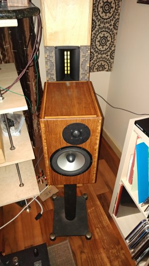

They are Zaph Audio SR71 88db
My sitting position is approximately 8 feet from the speaker. That is where I took that measurement. The room is a 12x12 bedroom with "soft" furnishing, carpet, bed, etc...

So you can definitely use those with our products, and I would not necessarily suggest adding his impedance flattening circuit for tube amps. The nice thing about those speakers is that they don't have gnarly low dips. While I think the Kaiju is a better match in terms of power and quality, but numerically the Stereomour should meet your listening requirements as well.

Do you have the impedance flattening circuit? If not, JK designed one for the SR-71. It’s in the article on his website. I built that speaker years ago and I am still impressed with how good it sounds. I would use the Imp. circuit and 8 watts (Kaiju) and you’ll be really happy.

Your room size should work with that combination. I have used an SII with SR-71s and it does work well in my listening room which is about that size. The 300Bs would be nice, but the SII is a really wonderful amp.
