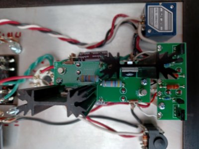

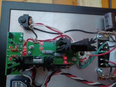

Had the Crack about a month what a cracker it is. Need a back stop on voltages  please,
A/C 242 v (U.K.)
1. 65.1
2. 183
3.0.4 mv
4. 183.2
5. 66.5
6. 0.2 mv
7. 102.7
9. 108.4
10. 0.2mv
Small board
OA 64.7
1A 182.2
B A/B 0.3mv
1B 182.2
OB 66.1
Large board
OA 103.3
OB 108.5
G 0.5 mv
B+ 181.9
Should I have mv at ground points,amp sounds awesome. Thanks BH.
Simon.
