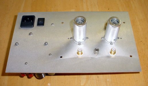

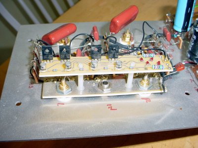

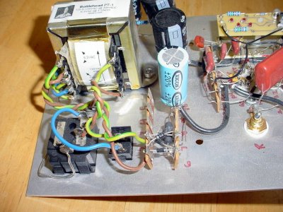

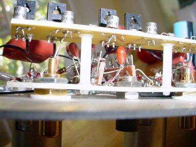

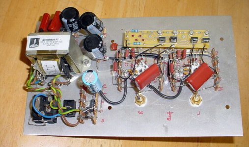

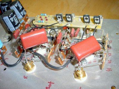

Hi All,
I recently purchased a Reduction phono pre from an estate.  The kit was completed (minus the base), but the owner passed away leaving no documentation as to the build.  Is it possible to get a copy of the Reduction assembly manual?  It appears from a quick browse here that the owner had marked all of the test points on the bottom of the unit.   I took a chance and fired it up on arrival, and the gain stage is working fine with no noise and appropriate output.  The RIAA portion is skewed somehow, and the test/checkout procedures should provide some help with getting it dialed in.   I have attached some photos, so any input the group would care to pass along would be great.  As for me, I'm not new to tube gear, I've built tube-based kits before, and am familiar with safety protocols for working on high voltage tube equipment.  I have a few good multimeters, and a scope that I'm trying to get set up (no signal generator yet). I consider myself to be a novice hobbyist with a reasonable level of experience (kit builds, recaps, etc).  Thanks all!

Reply #1 on: May 30, 2021, 02:36:46 PM
That's actually an original Seduction, complete with the C4S upgrade - nice find!
The Reduction uses basically the same circuit, with some changes to the layout and power supply, and a larger (8" by 10") chassis plate.
