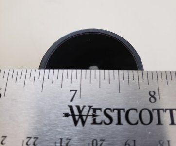

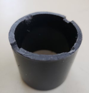

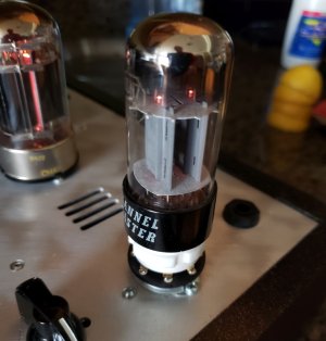

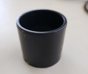

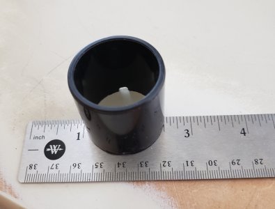

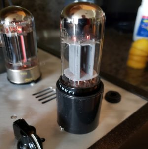

Hi! Just curious, what are you using as a shroud for the 6SN7 adapter?
Hi Toobuzz,
Don't laugh too hard. It's actually just a cut-to-fit end of a sink drain pipe from home depot that I had laying around. Prob $1 when I bought it. BUT, it works well to keep my ham fist out of there and it looks like it plays the part just fine so happy with it. It obviously just slides on and off easily for quick change of tubes. "Gravity Mount" as Bottlehead says. I used a small round file to carve out the plastic to go over the socket mounting bolt heads and stay flush with the amp plate. It kind of semi-locks in place and doesn't rotate when installed.
