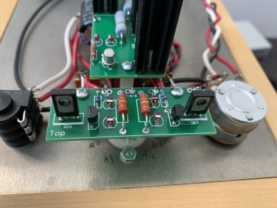

This week, I smelled smoke from the unit. Moved my hand close and felt lots of heat coming from it. I turned it off, unplugged it, then turned it over and a bunch of smoke came out.
Upon further inspection, I noticed that the wire connecting the power switch to the power transformer has been damaged (melted) from being to close to the 270 ohm 5W resistor that is connected to terminal 13L and 15L.
At first, I thought I could just replace the damaged wire which is probably where the smoke came from but would it resolve the high temp issue (the plate was burning hot -- I've never felt that much heat coming from the unit)?

    Your B+ voltage is awfully low.  What's your wall voltage?  The 58V at OA and OB is also a bit on the low side.  Typically I would expect around 50V at one of those terminals if a PN2907 was installed backwards.

    The PN2907 appear to be installed the right way.
      • Posts: 19778
    Reply #8 on: June 28, 2021, 03:32:48 PM
    I would reflow the solder joints on that small board.  You need to heat the solder joints until the solder flows through the board to the other side (don't add solder to the other side though that's hot helpful either).

    Reply #9 on: June 30, 2021, 12:16:45 PM
    That'll be the next weekend project. Thanks
