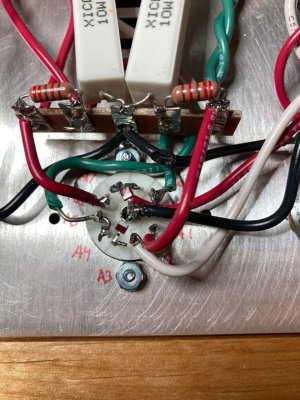

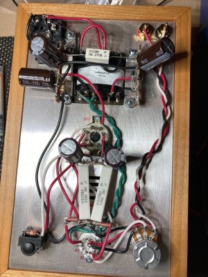

I've added some pictures of the wiring. Both LED's light up and the two sides of each tube glow.

You have a substantial miswire at your octal socket.
Some of the lower solder joints on the 1-5 terminal strip don't look soldered, or at least need some more heat for the solder to flow out.

Thanks Paul, I must've been half asleep when I did the octal socket. Corrected everything there and added more solder on the lower 1 - 5. The voltages are where they should be, the possible exceptions are where in the manual it says 0 V and I'm getting from 0.2 -0.5 mV. Are those within tolerances?

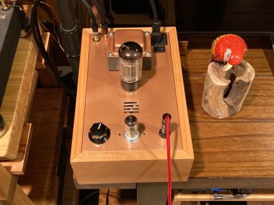

Here is a picture of my finished crack, put the Bottlehead badge someplace for safe keeping but can't remember where.

Looks great!
