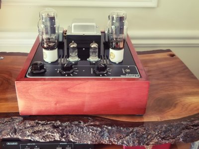

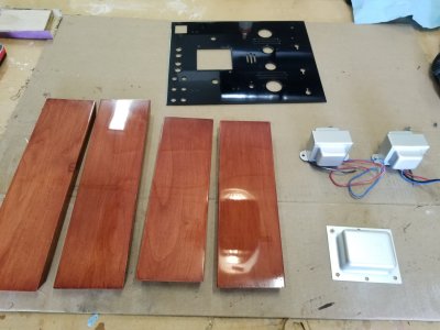

Well, I finally finished my stereomour II and I have to say that it was so much fun to do this build! This kit was exactly what I was looking for in a first build, all the components were included, instructions were clear and support was available (and excellent!). As you can see by the pics, I painted the top plate a piano black and the transformers in silver. The base is a cabernet stain and finished to high gloss poly.

I have noticed that the paint on the transformers seems to be "cracking" under the clear coat. I wonder if this just my shoddy painting or a result of heat? Anyway, not a major issue yet but may require a fix down the road.

Very nice looking build!  It's nice to have more than one amp.

Wow great job!

Very nice build. The finish on the base looks deep, with an almost liquid quality from the poly.
