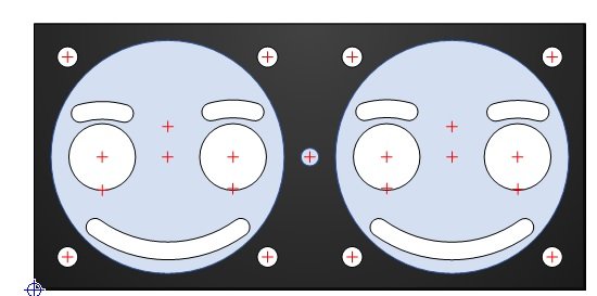

Turned the amps on this morning and meters work. Thanks for the replacement offer but somehow  I feel that 2 meters that exhibit the same issue is not very confidence inspiring. But I will consider your offer.
I know that I have some .080 dia. test point jacks somewhere in this mess so I whipped up blanking plates for the meters on FPE.
And I may mount the jacks with a 1 ohm resistor to measure current or just blank plates.
These a kind of cheeky.
