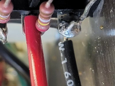

How is the solder joint where the black wires meet on the headphone jack?  Is one of those wires loose?
I do believe you have something loose or a cold solder joint that is causing your left channel to be a bit weak.  Swapping tubes can sometimes just move a flaky connection to make it work a bit better temporarily.

I have attached a poor (sorry about that) picture of the solder joint where the black wire meets the headphone jack. The solder looks similar on the other end of the black wire and also where the bare wire stretches across the jack; I wanted to take more pictures but my phone was being difficult. None of the wires seemed loose.
I left my soldering station at my parents and so will need sometime before I can reflow things, but I will do that once I get it all back to my place. I did poke around with a wooden chop stick, and with my hand, and found no loose wires - everything was surprisingly solid - except the B4 terminal itself (not the wire) felt a little loose; the rest of the octal socket terminals felt great.
