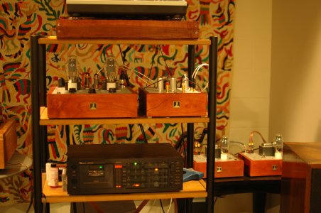

so i bulit this about seven years ago. it goes with the two mono blocks and an eros phono preamp. i worked on getting rid of the ground loop hum but now i have developed and loud hum right channel only not dependent on volume control intermittent in nature.  comes on as tubes warm up then disappears and reappears randomly with time. three peaks measured by advanced spectrum smart phone app at 64 hz 129hz and 236 hz.  the loudest hum peaking at 129hz.  i might add that this noise changes in volume.  again only the right channel.  i have also played with switching tubes and it still is only coming from the right channel.  any help would be much appreciated.  thanks.

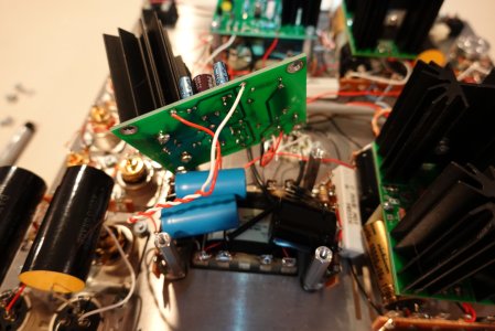

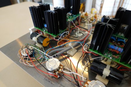

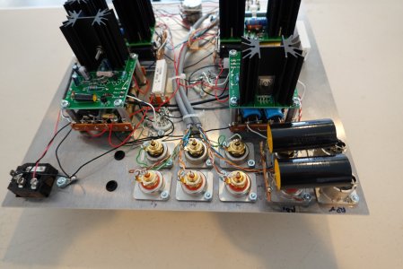

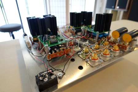

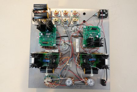

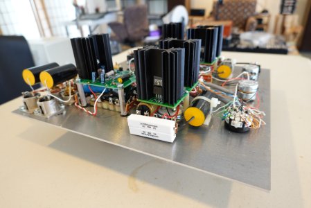

Can you post some build photos?  There isn't anything immediately obvious from the voltages.
Offline bgf
    • Posts: 33

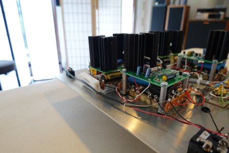

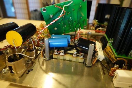

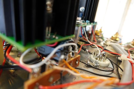

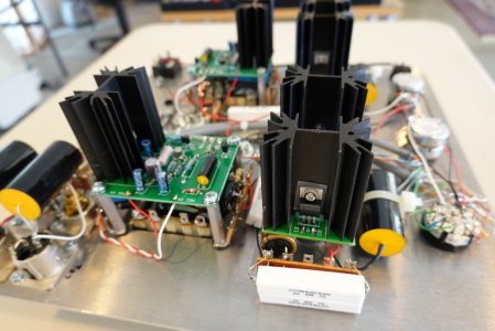

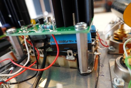

Reply #10 on: July 22, 2021, 08:22:03 AM
build photos let me know if you need some other views.
brent fauss
    • Posts: 20294
Reply #11 on: July 22, 2021, 08:49:04 AM

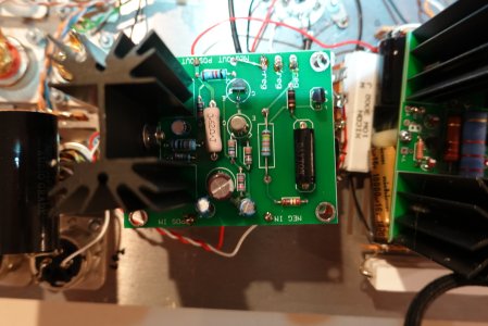

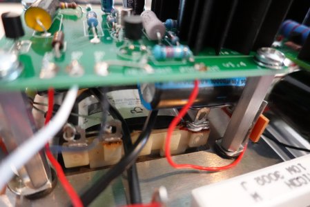

I would pop the power supply boards off and reflow the joints under there.
I would also post pictures of the bottom sides of the PC boards on the noisy channel.

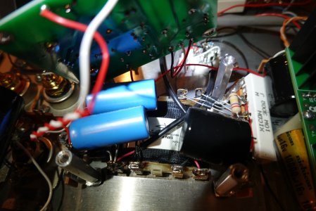

reflowed joints right channel no change added pictures
brent fauss
    • Posts: 20294
Reply #13 on: July 23, 2021, 07:21:14 AM
It's very likely that there's a loose cap or some other connection in here that you need to track down.  One way that I do this is to run the preamp into a cheap amp and pair of speakers, then poke around in the amp with a wooden chopstick to see if I can change the nature of the noise.
Offline bgf
    • Posts: 33
Reply #14 on: July 23, 2021, 08:57:44 AM
so capacitor tied in at voltage check point 36 and 37 when moved up and down changes the hum.
