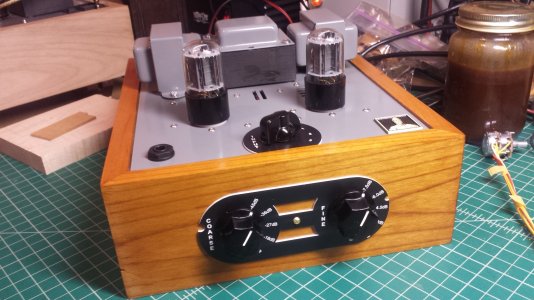

It is quite doable, I did this and other changes to a pair of s3x amps. I insralled the octal sochets with the keyway pointing to the left.
YMMV
