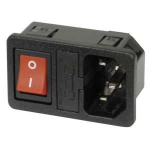

I am toying with the idea of doing a little bit of metal work to elongate the IEC cutout and use a switched IEC and doing away with the mains toggle switch and wiring. I could then use the vacant hole at the front for a lamp / LED fed from the 6.3v line.

You are most welcome to do what you would like with your kit.  Having said that, you'll want to be sure that whatever lamp you add to the regulated 6.3V rail doesn't overheat the regulator.  The hole up front for the power switch would likely need to be drilled out, and you'd have to find a light that would pass through all that material thickness.  The switched IEC module will work just fine, but cutting the chassis plate to acceptable tolerance to snap that in isn't so fun unless you have a mill available.
