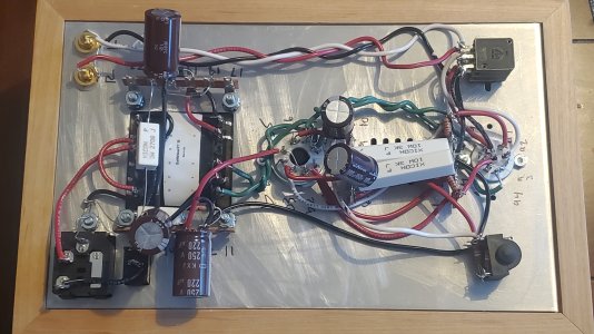

Just finished crack build failed resistance check. b6 and 9  showing  0 ohms.  Everything else passed. I thought it was because the wire moved while I was soldering b5 and  insulation got in the terminal. Fixed  that, it's still showing 0 ohms. Any ideas?
    • Posts: 20286
Reply #1 on: September 09, 2021, 08:38:16 AM
If 9 is showing 0 ohms, I would suspect that the wire that's supposed to leave 10 and go to the headphone jack is connected to 9 instead.
On the off chance that you have powered up the amp (which hopefully you haven't!) and the 100uF cap at 9 and 10 is backwards, it could fail and also give you a 0 ohm reading there.
Still, looking over build photos would be super helpful.

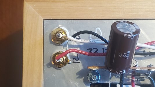

Thanks for the reply PB. I looked the amp over and moved some the sandblock resistor's wiring going in to 9L. I immediately got the proper resistances at 9 and b6. Then everything checked out but t22. I tightened down the transformer screws and got 0 ohms at t22. Voltage checks good ,leds light ,tubes light.   Nothing but static out of the headphone jack. how due I check to see if the problem's the  pot, vs headphone jack ,etc  ?
    • Posts: 20286
Reply #3 on: September 10, 2021, 05:13:39 AM
Can you post your voltages at terminals 1-10 and some build photos?

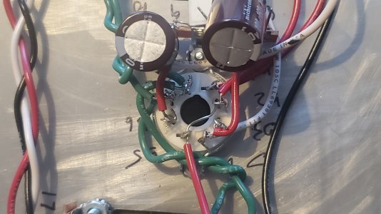

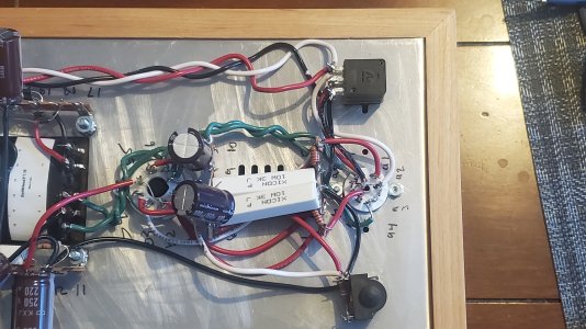

You really should clean up the green wires that go to the 9 pin socket.  The one that goes to A9 is supposed to have only 1/4" of the jacket stripped off, but it looks like you have 3/4".  If that wire touches the chassis plate, it will destroy the power transformer.  The same goes for the other green wire going to A4/A5.
Did you have the same issue with the stock volume pot?
