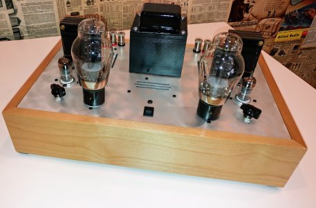

Here's a kit I built recently with the T&T original.
