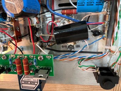

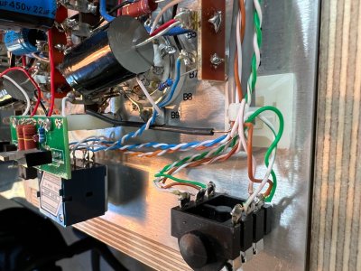

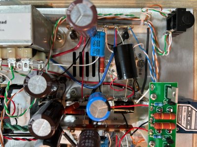

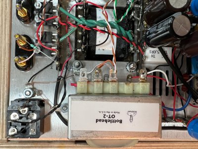

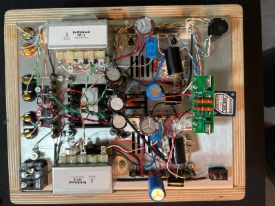

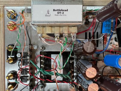

Offline LouisQ
    • Posts: 13

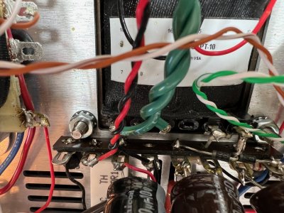

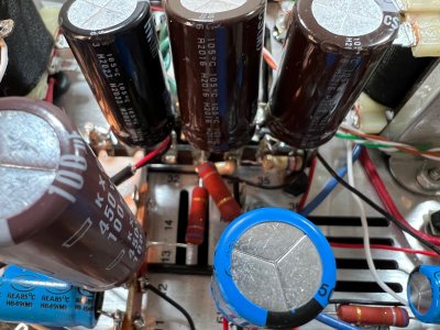

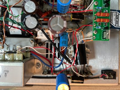

Reply #5 on: October 07, 2021, 08:55:11 AM
Hello Paul, Hello Doc,
This a kit that I bought and built last spring.
The issue started at the end of summer while attempting to swap the tubes (to GE 6FJ7).
By reworking the tube sockets I manage to relatively attenuate the first hum (10 o'clock) but the second (2 o'clock) is still very well persistant.
Maybe I damaged my volume pot (custom ALPS)?
Here are the pictures :
« Last Edit: October 07, 2021, 09:02:10 AM by LouisQ »
    • Posts: 9760
Reply #6 on: October 07, 2021, 09:09:44 AM
It could very well be an issue with the pot. Do you have the original pot to try in place of the Alps?

    • Posts: 20211
Reply #8 on: October 07, 2021, 10:32:18 AM
If terminal 36 is allowed to touch the power transformer nut, that can cause some hum.
The pot you have must be mounted to a PC board to work properly and reliably.  Just soldering wires to the pins will cause problems.
